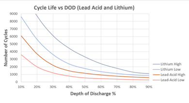

Cycle Life vs Depth of Discharge (DoD)
Battery manufacturers publish graphs for cycle life (aka number of cycles) vs DOD. Cycle life is the number of times that the battery is discharged and charged to the specified DOD before the battery’s Ah capacity drops below its rated capacity by a certain percentage. Below are examples of Cycle Life vs DOD graphs for lead-acid batteries and lithium batteries. Please note that these are examples only and are not representative for particular brands and models for these types of batteries.
As seen in the graphs above, Cycle Life vs DOD does not have a linear relationship. The higher the specified DOD is for each cycle the less overall energy (Ah, kWh) will be available for the system. Doubling the DOD will provide less than half the number of cycles available.
Lifetime Energy for a 100Ah Lead-Acid battery based on average DOD
Cycle Life (30% DoD) = 2,050 cycles; Cycle Life (80% DoD) = 630 cycles
Available Lifetime Energy (30% DOD) = 2,050 cycles X 30Ah = 61.5 kAh
Available Lifetime Energy (80% DOD) = 630 cycles X 80Ah = 50.4 kAh
Lithium batteries have a much higher cycle life than lead-acid batteries even with higher DOD levels. The cycle life of different types of lead-acid batteries can also vary. Therefore, the battery manufacturer’s cycle life specifications should always be reviewed when batteries are being specified for the system. It should also be noted that higher ambient temperatures and higher charge/discharge rates can reduce the expected cycle life of the battery.
