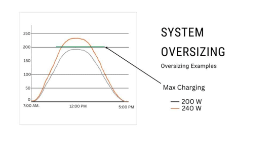

 Visualizing the difference
SS-MPPT 15L (240W vs. 200W module) on a Clear Day
 Oversizing-Examples-1-1024x576This graph illustrates the output power levels of a SunSaver MPPT controller—comparing a 200W module to a 240W module—operating on a clear & sunny day with a potential peak input array power equal to the STC maximum power (Pmp). The output power is slightly less than the input power due to the controller's efficiency. For a 200 W module, the max output power of the controller will remain below the max nominal output power rating of the controller. However, the 240 W PV Module exceeds that 200 W limit. With the 240 W Module, although you do lose the excess energy above 200W due to the solar controller capping, throughout the day, you have significant gains compared to the 200W PV module. The 240 W panel gathers more energy than the 200 W in the morning and afternoon when there is less solar energy available. This extra energy is pictured as the space between the 200W and the 240W Curve and below the max charging limit.
The daily peak array power and maximum output power of the SunSaver controller for a system using these modules will vary greatly on a daily basis.
