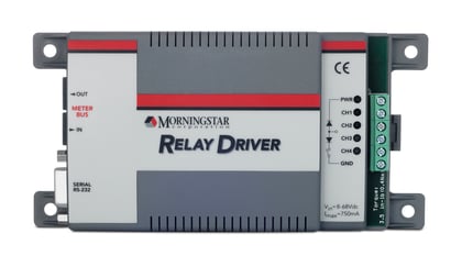

FOUR THINGS YOU MIGHT NOT KNOW YOU COULD DO WITH THE RELAY DRIVER
Adding a Relay driver to your system adds functionality that improves your control over the system. The Relay Driver reads digital MeterBus data from the controller in your system and can respond by managing additional loads, generators, and alarm indicators.

The Relay Driver can be a standalone device controlling your system with battery voltage, analog input voltages, and ambient temperature. Additionally, suppose your system uses a Tristar Controller. In that case, the RD-1 can read the following digital inputs from MeterBus: Battery voltage, charge/load current, battery temperature, TriStar heatsink temperature, PWM duty cycle, PV/load voltage, and all TriStar alarms or faults.
The Relay Driver has 4 channels that can function as inputs and relay driver outputs, with a max current of 750 mA.
